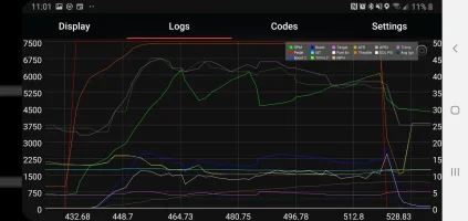

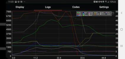

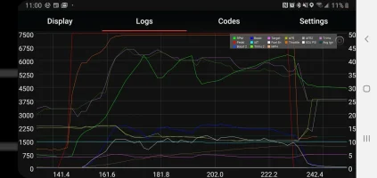

I don't think it's too much RPM. Here are three map 2 runs on the same day, ambient temperature within a couple degrees. Two of them don't have throttle drops, one does. The one with the throttle drop had the lowest max RPM.

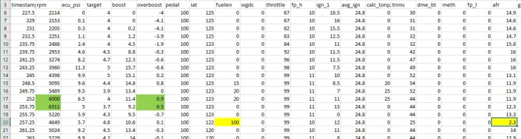

I did a bit more digging through my logs. Looks like the common denominator in every throttle drop is an overboost of at least .5psi above target whenever I'm over 6000 RPM. Here's a few snapshots. Yellow highlights the throttle drop, green is the overboost and RPM, blue are conditions where there was overboost, but the RPM was lower than 6000. So it looks like this is partially RPM related.
@Revvdmedia, could you send me a couple of your pedal to the floor 0-60 logs? I'd like to see if you have any overboosting or not.
I suppose the next big question is, what's causing the overboost condition?

Thanks for these. Looks like you are overboosting, but it's being compensated for by running super rich instead of pulling throttle. "fuelen" is how much fuel is being added, by percentage. Looking at this snapshot from your Husky 94 run, you overboost (green), then right after it dumps in 100% of whatever it can for fuel (yellow), bringing your AFR all the way down to 2 (also yellow).
Unrelated, but further down the log (not shown), your AFR goes to 3.8 for a while once you're completely off the gas and on the brake. From what I've seen, and understand, AFR should go to infinity (shown as about 25 in our logs) when you're not on the gas since we have direct injection motors. For reference, I've never seen my AFR drop below 9.5 in any condition, whether full throttle, part throttle, coasting, or braking. You may want to have @Terry@BMS take a look at that log.
I'm sure I've asked this already, but I forgot. You have the fuel wires connected, right?
