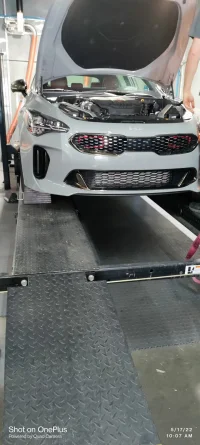

Shame the JA air scoops were discontinued a while back. They're huge. You see how big they are behind the grill of my car.
Wow, those are YUUUGE!
Does the primary rad still function with those in place?
(I kid, I kid...)
I actually prefer the Velossa ones as they're big enough to do what needs to be done.
IMO, the JA ones are too big and will create almost a drag effect and create extra load on the mounting points ( assuming you're travelling at a decent speed most of the time ).
Also, with Velossa's you get more direct air than standard, which in turn means more bugs and dirt / dust directed towards the filters ( yes they should be changed from OEM and cleaned more often ) but with the JA's, 'significantly' more so.
But, to each their own.
