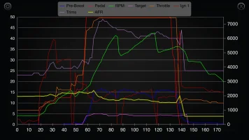

Attaching screenshot of the small dip.
How this look?
Looking at graphs doesn’t really help much, but you want to show timing advance option to see what is being pulled or added.
That red line is ign1, which is timing advance.
