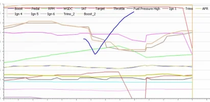

Map check in please
Map 5 2nd run
More boost doesn't necessarily mean more power. What gas are you running?
I'd like to see a Map3 run. Those runs don't look good. I believe you are trying to put too much boost without the oct. Timing does not look good and boost should be way higher. Looking at the ECU timing, I can tell the car is pulling boost out. Do you have EWG?
That's a pretty long log and only the very last pull had a WOT worth evaluating, but it looked good. Timing was much better and you basically had the same amount of boost in 2nd gear as Map 5. ECU psi peaked at 12psi where it should be, most of the Map5 runs ECU psi hovered around 10psi. I think that's the sweet spot
Some timing movement. Longer full throttle run on map2 or map3 for comparison?
Thanks. How about a single Map 4 run WOT/100 + MPH ?
