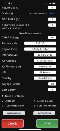

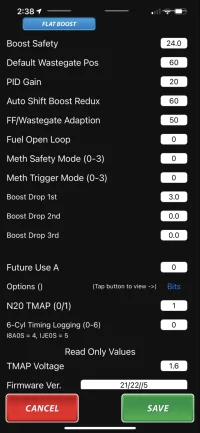

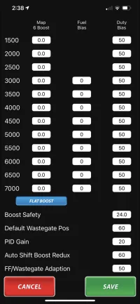

Here are all of the settings I tried with the last run.

I would take out the setting in Default Wastegate Pos, put it back to 0. That is an experimental function for lag fix. You've already taken care of that with the pedal commander, and with EWG wires it can cause issues. Everything else looks good and is already set up as a base. Give that a shot and see if it makes a difference. Also, what kind of issues were you having? Can you describe it in detail, that might help.
