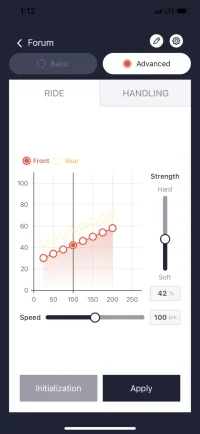

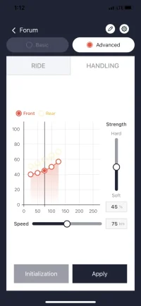

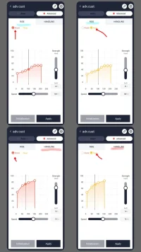

I’m not D.J., but I’ve been enjoying my Mando SDC EDS10 for a while now. It allows me to fix what I thought was the worst handling behavior for my use of the car…the wallow in the rear on anything but smooth curves.

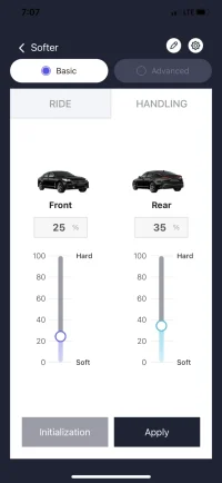

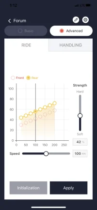

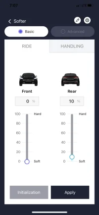

Yes, a rear anti-sway bar is likely the best solution, but I’m able to tune out most of this by ensuring the rear stiffness is higher than the front by at least 10%…even in the softest comfort tune.
Plus, I’ve created a tune that both more comfortable and more sure-footed and a tune that’s capable of canyon carving. You can (well, I can) really feel the difference between them.
We’re only changing dampening characteristics here, so no real changes to steering, but with roll and pitch better controlled, there is a bit more immediacy to the steering since there’s less body and suspension/steering movement to wait for. The car feels a bit lighter, sharper, and sure-footed.
Best bang-for-the-buck so far!…though I REALLY wish a tune select (not tune edit)
CarPlay app was available. I’d rather not have to pull over to switch tunes.
Enjoy!
