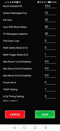

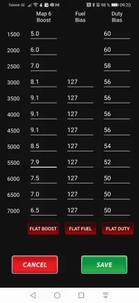

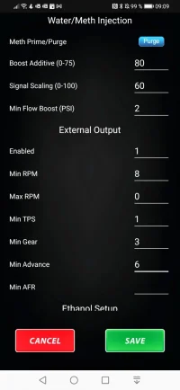

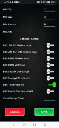

Seems I will be the first to publish JB4 Map 6...
...hope you guys will shime in here...!
Map 6-2 Corleone.jpgMap 6-3 Corleone.jpgMap 6-4 Corleone.jpgMap 6-5 Corleone.jpg

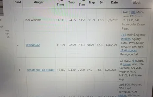

Here was last track slip, he was having a problem a torque safety shutting down his launch and still ran a 11.11, working with Lozic and others to remedy the situation. Video is on facebook
Yes we are still working on a solution to solve the torque limit. It only happens at the track when it's sticky and the wheels do not have a little bit of spin. I went back to the track a Thursday. Having completely removed brake snip barely did any tire deflation 28 rear 30 front. I was only building 5psi sport mode launching around 2100-2300 rpm. It would still slam the throttle closed some. So I had to resort to launching in 2nd gear with only 5 psi 60ft suffered bad at 1.8 i was still traping 124-125 running 11.2s. My awd tune should be here this week I'm hoping it will solve the launch issuses at the track.Sorry I haven't been getting emails to say anyone has been posting in here. I do have videos of the 2nd gear launches on Facebook IMR stinger page. And also on my Instagram. As soon as it let's me do a proper launch at the track I would think you will see a 10 on paper atleast that is the plan. As of rightnow the crappy 11.111 run some how is still the best on paper slips for the stinger. That time won't last for long someone is bound to beat it. And yes I use my ewg wires and fuel control along with running the jb4 on every pass. Sometimes it's all disabled besides the need to operate the cpi and get logs. Depends on the weather and situation.
