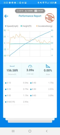

I finally installed my remapped Lozic Ecu
1.4 bar.
My only way to measure 0 to 60 is with JB4 Map 0. But I do not know how accurate the times are.
Stock- map 0 2 runs- 4.876, 4.9
Map 2- 4.625
Map 0 Lozic ECU- 4.150
Map 0 Lozic ECU and TCU- 4.1 (spun alot all season tires) gonna take some practice with TCU.
I also noticed a few things. On run with lozic ECU, TCU & Jb4 map 0. Started in 3rd gear manual mode about 30-40 mph full throttle to 5th gear 110-115.
When I started breaking down to about 70mph it automatically downshifted.
Today I did another run with JB4 disconnected and performed flawlessly.
The other thing I noticed is not until I disconnected JB4 was that the shifts were not as harsh.
These were some short pulls on strait ms109 with the lozic 1.5 if anyone was curious about the octane and timing.
Seems that Lozic had add 2-3 degrees of timing compared to JB4 that uses stock timing. Normally 3 degrees will add some power and crisp... if you not already is near limit.

I found you need to launch fairly soon or too much boost is built, which causes the spin.
Do you turn traction and stability off?
Yes I do to. And you have to paddle shift even with the tcu tune

So you think JB4 is somehow effecting things even on Map 0?
If you want to stay in the best range just for drag racing then yes. For regular driving I don't.
