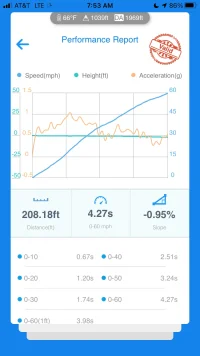

This was a 0-60mph run I did this morning using launch control letting it auto shift. 2nd run I got 4.30s and my rear tires spun a little (I'm on the summer PS4 tires). This is on 93oct fuel using the Lozic 1.5 bar tune - I didn't do any pops/bangs/bubbles for my ECU tune as my catback already pops/bubbles enough for me.
Assuming the JB4 is reading correctly and showing the timing corrections as they are (which I guess I feel it is) then I feel like I'm getting too much timing corrections. I've seen boost spike as high as 22psi - that has to be too high on pump fuel??
