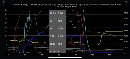

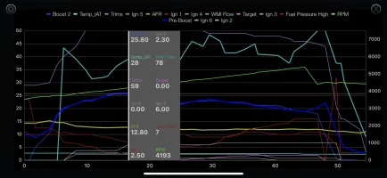

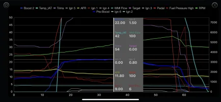

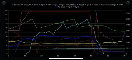

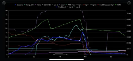

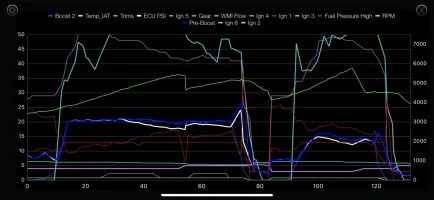

The HPFP pressure breakdown on the e85 mix isn't just a boost issue.
It is a situation where many things overlap, so you need an appropriate setting there.
Some customers here use 24.6 psi.
Some customers use the Full E85.
In addition, it is to make the car work well with the setting tailored to the situation and get good results.
I can't increase capacity up the hardware.
I make the settings that best fit within the capabilities of the hardware.
Getting a boost is easy.
The goal is to proper boost and gain power.
This car using Full E85 with JB4 CPI. with stock HPFP
Due to the lack of capacity of the JB4 CPI, this setting was made.
Set within the allowable capacity.
Some may not get good results by running WMI or CPI.
So what we need is a setting.
Good results can be obtained only when the missing part is obtained through the setting of WMI or CPI.
I also made a lot of effort to compensate for the capacity of the JB4 CPI, which is lacking in this Stinger, and got good results.
