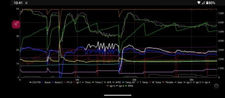

Showed it to Lee/ Lozic he said it's fine the car is working good no need to change or do anything, I might be overreacting. But I did another roll from 40mph in third gear and peak boost was 23.6 psi, so maybe the 25 was a fluke!
First log the one with 25.3 psi
Second log with the 23.6 psi first two pulls Jb4 map0 the third and fourth pulls in map6 boost safety 22psi

I had a peak boost of 25.3 psi today with the 1.4 bar 91 tune running E30. How do I use the Jb4 to limit my boost to 22psi?

Lozic told me that I needed a longer pull to let the ECU learn more. So I did this pull and the highest boost that I have seen was 22.6 or something then it tapers down to 17. Also my fuel pressure dropped to 9 when I hit 25 psi afr was good.

well the fact that you ordered a 1.4 bar ecu which is 20 psi and it constantly hits 22+ psi is enough for a revision... again just because it didnt overboost this pull dosent mean it wont overboost again... if it did once it prolly will again

The 22 psi at the beginning of the run might be because of the boost ready function set to 3k RPM, and TBH it doesn't worry me much because when I was on Map4 I used to hit 21~22 psi after every upshift.
I'm getting retuned for lower boost, going with 1.3 Bar on 93, and boost ready at 4k keeping it at low intensity.

Mine was 3 one side and 4 for another. I happened to notice that my LOZIC runs lower boost than anyone. And it’s also super hard for me to add extra boost with JB4 when playing with map6. Also when I was tuned by SXTH, my boost is all over the place and almost impossible to dial. Then someone who’s also using BEF asked me to fix my wastegate and bingo. Both JB4 dialing boost and SXTH stage 2 is flawless now.

My boost looks like a heart rate lol.
Sorry can't attach the log something wrong with the server or something.
wtf??? please send me this log in a csv file...are you using jb4 to reduce boost? my god... ecu looks like its requesting up to 27 psi multiple times
