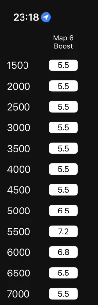

Great will order that and see what happens. Also this is a map4 log and a map6, I'm trying to get a flat boost but the up shift spike is killing me.
I have came as close to as flat boost curve as I have seen (with Yves help.) I have a 1.3 bar that peaks at 20 and never less than 18 at shift. No big spikes anymore either. I think boost ready at 3k on low would be perfect if you are roll racing a lot.

That is what I would go for then! I’m always happy to help with map6 once you get it.

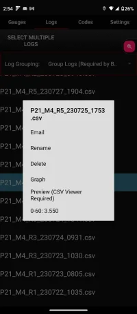

Actually the G80 doesn't have a factory launch control, but I braked launched it once Jb4 says 3.55 seconds 0-60 I know it's not that fast but the tires are shit it kept spinning.Screenshot_20230801-145406.webp
