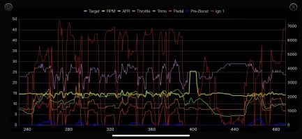

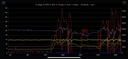

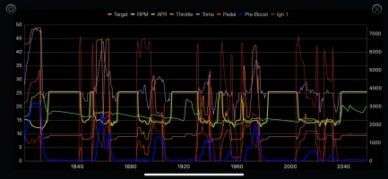

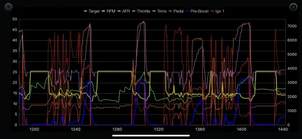

Can someone help me read my graph from my jb4? I’ve installed the Ecu, tcu, and awd if that matters. Thanks guys
  • P21_M6_R2_220623_2242.csv
you need to disable fuel control wires! and none of those are good enough runs to say whether its running good or not! do a third to fourth gear pull wide open throttle and why are you running map 6? do you have wmi?
