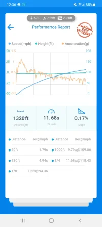

I little better let it cool off some and got use to launching more. Same fuel and same place.Screenshot_20210516-003634_dragy.webp
Looks good! You would be 12th on the 1/4 mile leaderboard!

The car is fast, no doubt! Stock, it would run high 4 second 0-60, and right at 13 seconds in the quarter mile as per Dragy, which I've previously posted in this thread. Now, it'll do sub 4 second 0-60 all day long, with sub 12 second quarter mile.

Here are the best times I've ran so far:
