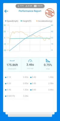

Not the fastest Stinger out there but I'm happy considering no meth or piggyback. Just the Lozic ECU+TCU on a E16 fuel mixture (93+E85) with a good launch.
