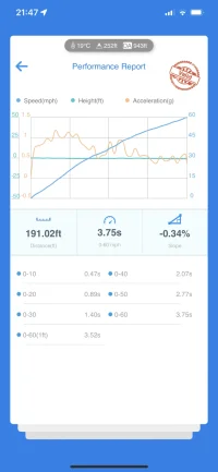

@those who got the Lozic TCU + JB4:
Does it make sense to play with the „auto shift boost redux“?
Asking because of the harsh drop left of middle (see pic)
Or maybe its just a pothole
Thx all
Marian from germany

I won’t be much help on advice.. but I just looked at my best 0-60 when I have the JB4 and TCU only. And also looked at the best 0-60 that I had with the ECU and TCU. They are both very similar to your drop off at the same speeds etc. Hopefully so people can help.

Also…just for fun I went poking around on the draggy leaderboard. All stingers have that same drop off that you are seeing. Some just a little more severe than others. To me it looks like it’s at about 30-35mph when it’s happening. Even the fastest stingers out there have the same drop.
