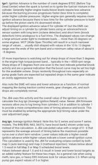

I'm still in the learning phase of interpreting logs. The n54tech website states exactly what @Yves998 is saying. 5 or higher is normal for pump gas and heavy E mixtures/WMI should be below 2.0
Yup. Considering ECU can pull up to 12 to save our ass, any pull below 6 for your daily driving optimal gasoline still gives ECU a lot more to pull when you’re running crappier gas or having heat soak.

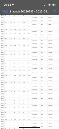

I was wondering if someone could help me decipher my logs. I read somewhere that on pump 93, your timing should be less from 2-4. I did a pull 2nd - 4th (1.5 bar ecu only). I’m still figuring out how to read the logs and to understand what they mean. You guys are way more knowledgeable than i am so I appreciate the help.

From my limited knowledge it doesn't look awful.. looking and ign 2-6, 2-4 are within tolerance but curious why ign 6 is pulling significantly more timing and 5 is up there as well. I believe with pump gas the tolerance for these values are expected to be higher but it seems to me it should be fairly uniform across all cylinders.

The log suggests you are just exceeding your fuel quality with the level of boost the car is trying to push. Others will chime in.
I'm running 93 octane with WMI and pushing peak boost numbers in the 21-22 range and ignition 2-6 will typically stay in the .8-2.3 range. I'm guessing for 93 octane you would likely be better off at 1.3 or 1.4 bar tunes. Also, if you have access to e85, you could try adding 4 gallons in to the mix with your 93. On the other hand, if the car feels like it's running great, just enjoy it, in spite of the fact the ecu is retarding timing a bit.
