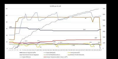

@TorkMe, I’ll also add that without the fuel wires I’m very Lean up to 14-16mph (15.04 range and then everything moves into a much better 11.5-12 range from there out.
Where is the ECU tune transitioning to the safer AFR range? Trying to figure out how much faster the ECU intercepts that WOT punch.
From my logs and charts I've already posted my car goes to 12 as soon as you are wot. Just a tiny bit higher prior. Remember we dont get wot until around 10 mph.
I’m still impressed by the flat AFR curve. Your speed is actually a little quicker in the midrange, slight parable effect vs my linear one (ie: you are faster in that midrange area.

I am more than willing to dig deeper into the logging and ECU correction, but first, we must understand what we are looking at. When I say look at how jagged the logs look from the piggy back vs a tune log. Do you see the differences?
Note, that there is lag time in reporting to the obdII reader. With live emulation it happens much faster, so its not running lean at that point, its just taking longer to report it to the OBDII port. I think the delay is .3 to 1.0 seconds depending on on the prority of the system that is reporting the data.
Watch boost and ignition timing with your fuel curve, they should mimic each other, but fueling will have a small delay, which is very common.
Now, how fast a piggy back works to intercept and send those signals, you will have to talk with the respective manufacture of the piggy back. Also, you will need to know the priority or order of adjustments that the piggy back makes. Is it boost adjust, ignition, fuel? Or, fuel, boost ignition? Each item that is adjusted has an order of importance, or speed (hz) that it can adjust in. I am sure that most piggy backs are going to be fast, but it would be interesting to see if they are faster than the ECU processor.
