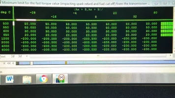

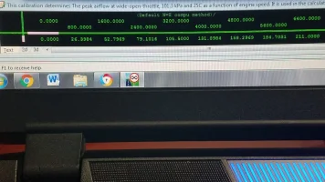

    Yes, that is true for an ECU tune that has been optimized to a specific car. Most other companies offer an off the shelf ECU tune and it has limited customization since it is built for 'everyone' and not an individual car. But your environment / ambient temps / humidity is much different in the NW USA than mine in the SE USA.
    Personally, if I bought an ECU tune from you it would drive me nuts sending the ECU back to you to make an adjustment since I can barely wait 2 days for Amazon packages :rofl::rofl:. Pressertech is closer to me but I feel they're not at the same power / tuning level. I'd be more interested if you offered an off the shelf tune that eliminates the torque limits, throttle limits, and airflow stuff that you posted above and then fine tune it with a piggyback so I could run different levels depending on my environment.
