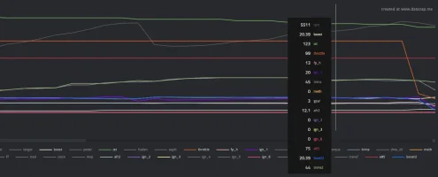

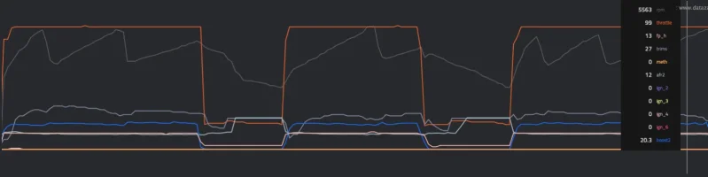

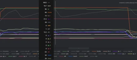

E65+ with no CPI is now possible with LAP3 Performance! Never thought this was possible but here we are. I was given the opportunity to try the latest ECU Tune from LAP3. The new LAP3 Stage2.5+ Tune aka LAP3 Linear Boost Tune is a game changer.
With my last car, I was able to run E85 when paired with LAP3 ECU and CPI. With the new tune, and I am now able to run E65+ without CPI/Meth!!! The best part is, AFR, Fuel Trims and Fuel Pump are spot on with every single pull. Fuel pump is happy, AFR stays at 12-12.2 and fuel trims are 25-30ish. Attached a few screenshots of the logs. NOTE: “METH” on the log shows CPI duty cycle and as you can see it says “0” which means CPI is turned OFF. One log on E65 and one on E75. Then one showing back to back runs and how consistent the data is
Again, no WMI and no CPI.
