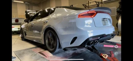

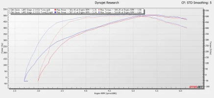

1CAD63C0-B150-4E69-975F-8C08CB922F70.webp7E67ECF8-2B30-420B-A1E4-D1AD9BFB5B11.jpegE7644C0A-AFA1-424A-ABB6-CA0A2D72EB1F.jpegFirst dyno day, 507 WHP
2020 RWD GT1
11.48¼ mile @ 127.3 MPH
LAP3 stage 2.5 ECU
LAP3 stage 4 meth kit on 100% Meth
With DO7 nozzle
AEM Intakes
BMS FMIC
NGT Catless Primary’s
Stock secondary’s
Borla Type S Exhaust
HKS Plugs
#lap3 #lap3usa #lap3tuned #pross #dyno #kiastinger
Quick exhaust video with the LAP3 2.5 ECU tune and "crackle/pops" set above 3500 RPM. While driving normal I never hear them but going higher up on RPMs and decelerating you can for sure hear them. I set them higher in the RPM with the tune just so normal driving wasn't too obnoxious for me. My exhaust is pretty mellow so others might have it a lot louder with straight pipe. I have HFC primary then stock exhaust with mufflers replaced with resonators.

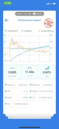

Is this fastest, stock turbos, full weight, daily driven Stinger in the world?
Dragy- 11.00 @ 125.95mph (peak 20 psi)
No weight reduction. On my way home from work.
2022 GT1 AWD
Lap3 Stage 2.5 ECU
Lap3 Stage 2 TCU
Lap3 WMI
Lap3 Catless primaries
Muffler delete (added resonators)
Pump gas
20” Vertini wheels
Stock FMIC
Stock secondaries
Stock battery
Stock heavy interior
No race fuel or CPI
No stacking with a piggy back for extra boost

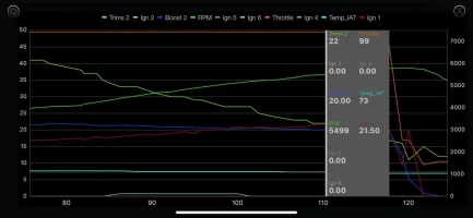

Here is a log from today. Colder weather so its boosting a bit more. ECU is pretty adaptive.
Ok, about 35 degrees here been seeing on average 21lbs of boost through most the rpm range and about 700 feet above sea level.
