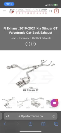

Anyone currently running the frequent intelligent exhaust ? Love the sound of it. Would love to hear some feedback .

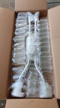

Well look what I got today.....
Was supposed to do something responsible today but when this showed up :sneaky:

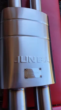

First, lets get the exhaust porn pics out of the way.

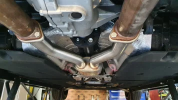

Now, I don't know if this has been said by anyone else before, but here's why I decided to get this.

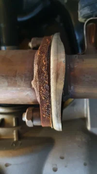

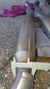

1. The OEM MID Section starts at a respectable size

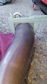

and narrows down towards the rear

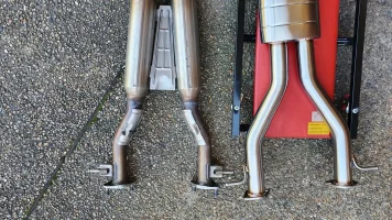

My Bi-Modal mufflers are 2.5" ( 63MM ) so the difference was noticeable.
But now.....

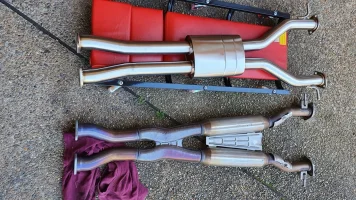

And here's a couple of pics for comparison's sake...
At first start, it sounded like an M5 but I'll let it carbon up and settle down then I'll do some vids.

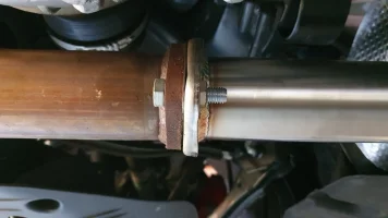

Easy to install but not as straight forward as I thought it would be. Also, new bolts and nuts are required to replace the studs / nuts in the rear.
Once the car was up and I had tools in hand, 30 mins and that was taking my time.

Now I've been for a drive, I'm even happier.
There is almost NO SOUND in the cabin ! It all goes out the back.
Also, I expected no performance gains. Wrong !

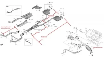

Just trying to get information so I understand. Is this the order it goes. Down pipes then mid pipes (do they have the catalytic converters?) then the exhaust. Is that the sequence it goes? I also just want to make sure it will pass emissions testing. Thanks.
Also I have a 2022 GT2 with variable exhaust. I don’t want to loose that. Anyone know if any exhaust manufacturers have the variable exhaust feature available? I may need to what awhile until it’s addressed. Unless they have already.
The Section labeled Mid pipes in the photo do not have any catalytic converters. Secondary downpipes or primaries do in fact have cats (catalytic converters) but there is no o2 sensors there so you probably will still pass smog with them removed. I passed mine. However a cat back like he has will for sure not throw an error for smog. Don't know if they will do a sound check though
