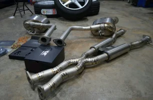

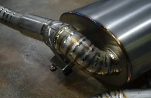

In korea there is a new exhaust that is getting a lot of attention. It is the RES titanium exhaust (catback with variable valve).
It costs about 4000usd so almost twice the price of other exhausts but it is said to sound very good and have absolutely zero drone (people say). Also, it is almost 20kg lighter than the stock exhaust.
Anyone heard of it in the US?
There is no video on youtube but maybe you guys can check this korean site:
res 스팅어 : 네이버 동영상검색

The only thing I would question about the RES exhaust is the piping diameter which is quite small I believe. If somebody could confirm.
I asked. Stay tuned.
I got the answer: 60pi 50pi 63pi.
Is that small? I am no expert..
I believe most after market exhausts for the Stinger are 62.5mm (2-1/2") . I may stand corrected though.

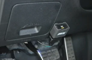

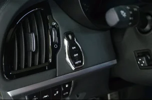

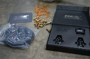

BTW one thing I forgot to mention:
You can set the exhaust valve to automatically stay closed under a certain RPM and open only when beyond that number. (e.g. 2500RPM)

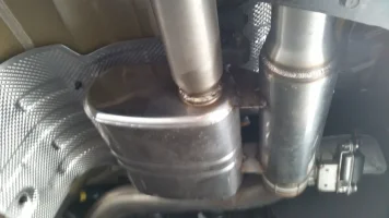

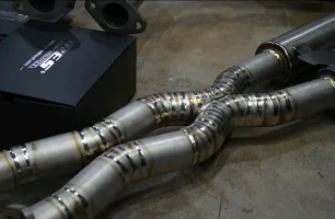

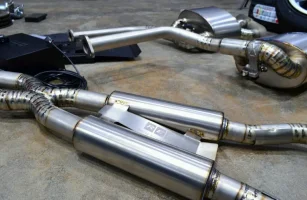

Some more pics:
Got it.
Makes sense. The exhaust is a 2.5" theoretically.
60pi is the size for the mid pipe section
50pi is the size of the section after the mid pipe until it reaches the valve.
63pi is the size of the section right after the valve on the mufflers (the difference can be seen in the photos posted)
Some more pics:
That's the industry standard now (for other manufacturers of higher-end vehicles). RPM based, plus "manual" open at all times based on drive mode. Any bi-modal system I would pay a small fortune for would have to have that functionality.

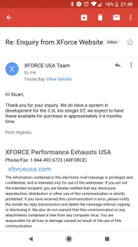

This information is probably already out there but i received this from XForce Performance Exhausts on July 9th.
“Thank you for your inquiry. We do have a system in development for the 3.3L kia stinger GT, we expect to have these available for purchase in approximately 3-4 months time”
Interesting. A week ago they told me it will be released in August.
