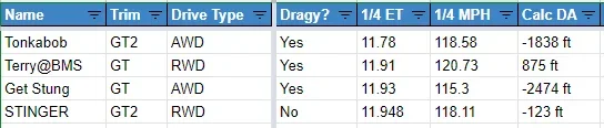

Given we have a few cars in the 11s now I think it would be useful if we started measuring calculated DA for all physical drag strip runs. If you're posting a slip you should include track elevation, air temperature, humidity, and barometric pressure. STINGER's run was -123ft calc DA which is seriously awesome turbo weather. I added a column in the Google sheet for Calc DA going forward

I added calc DA's to the top 4 times on the Google sheet based on location and weather details of the day the Dragy / slip was posted (this took me entirely too long, but it's awesome data to have). Maybe this will put to rest the amount of doubt that Get Stung received over his time... look at that DA!
I corrected my DA to - 1879 and added Tork +791 and Jesse P +724 as i had the slips handy.
