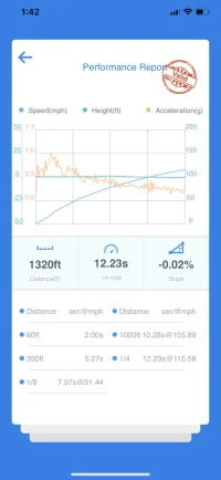

A93EBF6B-189A-4C2C-A090-DE433C8DA136.webp Beat my best 1/4 mile and 1/8 mile run today. Wish I had 1/4 of a tank it or less to save some weight but I’m still happy with this. I installed bms intakes and it helped with my times and trap speed.
Getting better! Not bad for a heavy car. :)

View attachment 19394 Beat my best 1/4 mile and 1/8 mile run today. Wish I had 1/4 of a tank it or less to save some weight but I’m still happy with this. I installed bms intakes and it helped with my times and trap speed.
What are the mods? Jb4 and intake?
