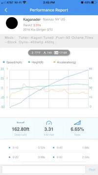

Kagantuned just took the #1 0-60 spot with a 3.31 even while going uphill on an almost 7% incline.
This is on just standard 93 octane and only mod is a HFC downpipe. Stock intakes, exhaust and secondary cats. Amazing, and he’s just getting started.:thumbup:

Yes it’s baked into the ECU tune and not using the brake switch. He worked for a while fine tuning the parameters for launches and made several adjustments to rpm, boost, throttle opening, etc. to maximize power while limiting loss of traction.

That is a ripping 0-60 time from Kagander but I've never seen a Stinger that doesn't show the Gs drop for the 1-2 shift and 2-3 shift. I'm very very very very suspect. The turbo spool is also very slow, also un stinger like. This is going in the hoax bucket for me.
What's that mean, exactly? You thinking it's a different car or the mods are more than what's being reported?
