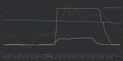

Here's an example... This is using Map 7. 60 additive, 90 scaling, and min boost at 7. This was my best WMI run so far @ 4.13s, according to Dragy.
Link: datazap.me | Toddasaurus | MAp 7 0-60 Run
Picture... (removed ignition values so you could better see the boost graph)

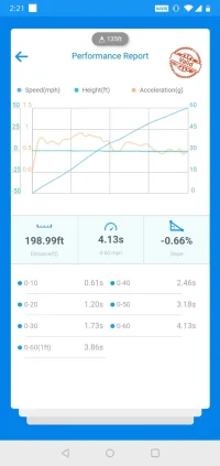

And here is the Dragy slip associated with the above log....

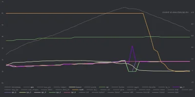

And the same Map 7 settings doing a 3rd gear pull from ~20mph up to redline.
Link: datazap.me | Toddasaurus | MAp 7 3rd gear test
Picture...

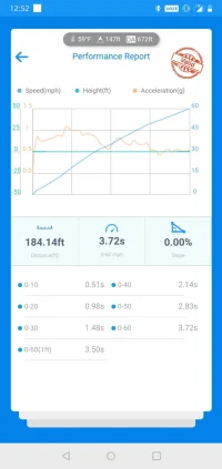

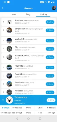

Excellent results Mr. T.New record for me, and an even stronger #1 position for the Genesis crowd.
No brake snip.
