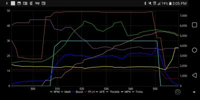

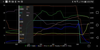

That 16.5 AFR at 3000 RPM would concern me. What was your 1/4 mile time?

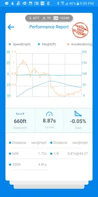

This is also a 1.72 with 3 PSI, AWD, on the street.

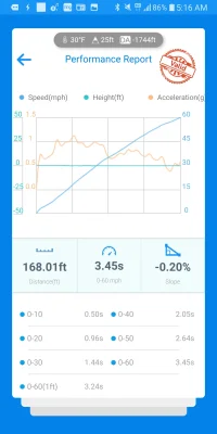

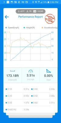

Screenshot_2020-03-12-21-09-21.webp Screenshot_2020-03-14-15-05-51.webp Screenshot_2020-03-14-15-05-55.webp Screenshot_2020-03-14-15-06-28.webp
Time was a 12.09. 5000 da really hurts. I’d love to have an awd but I’m starting to really get the rwd figured out
Great time for the DA. Great RWD launch as well.
