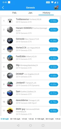

3.99 on map 5!
BACK ON TOP!!!
@xot1 - this for yoooouuuuu!!!! Haha
Next up, ECU flash and new intercooler. I will crush my own 0-60 soon enough.

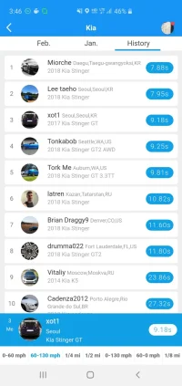

In my case I stole back the 60-130mph from @Tonkabob :p (#1 and #2 are big turbos)
Congrats Xot. 60-130 isn't my main focus with my gt2 awd but i will relieve you of the stock turbo title just the same!

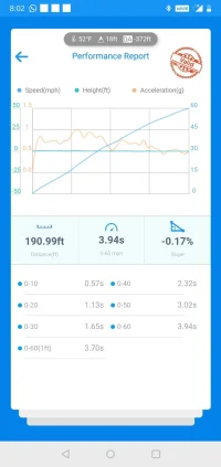

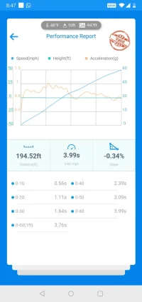

So, i did more runs tonight after using up some gas (my last best timed run was almost with a full tank of gas), and also to prove to myself that my best time wasn't a fluke...
It wasn't.
My new best with Map 5. Intake, midpipes, exhaust. AWD G70 Sport (heaviest G70 trim).
I am quite pleased with this result.
Impressive runs!
Something tells me this time will continue to drop over the next few months... :)
