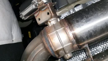

So I have noticed a few days ago that my exhaust is rattling occasionally on low revs, I first noticed it when I was at the drive through and the noise that echoed off the wall sounds like a metallic "zing" when accelerating from a complete stop.
I pulled over to check where the rattling came from, it seems like it's only coming from the driver side exhaust. I'm not an expert but it almost sounds like the valve is rattling as the exhaust is vibrating, it's a very obvious metallic rattle. I tried to replicate this rattling noise as it comes and goes, changing to every modes and accelerating slow and fast with no consistency. I did however, noticed that I can replicate the problem more in sports mode than any other modes. It also happens a few minutes after a cold start when the car is idling, but not every time. I have managed to make a few videos to show the mechanic when I plan to take the car to a dealer to get this fixed. I have managed to record a video when the exhaust was rattling continuously when idle. The sound does go away when I accelarate or drive normally.
I have read that ShannonC had a similar issue a couple years back and Kia decided to replace the entire exhaust system:
I am hoping that it just needed a quick fix although a full replacement would hopefully eliminate any issues for good.

It should not rattle unless something has detached from the valve mechanism. Have a look underneath to see if anything in obvious. Here's what mine looked liked when a retaining pin failed/wasn't correctly installed.

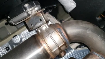

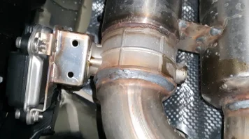

Thanks to your information, I think I might have found the cause.
This is what it should look like on my left exhaust which doesnt rattle, sits flush:

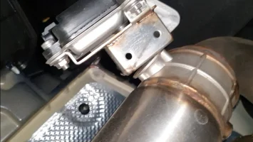

This is what it looks like on the right side, which occasionally rattles:
Looking forward to showing them what I found when I take it in to the dealer this Thursday. I just have to take it easy in the meantime and not push this thing on sports mode.

Yep that doesn't look right.
@fendushi
Looks to me like yours might just be a case of misalignment so hopefully an easy fix. In my case the entire actuaror dislodged causing the valve to move freely and making the same rattle you're experiencing. Initially the dealer unplugged the actuator and sought advice from KIA who insisted on replacing the entire exhaust rather than sourcing a retaining pin and a few bolts. I think it took about 2 weeks to get a new unit delivered but I was only without the car for maybe half a day.
Added another image...
