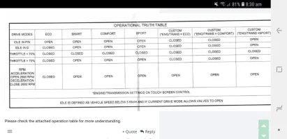

Exhaust note depends on RPM.
Eco mode the valves stay closed at all times despite RPM, so it will be quieter

Hi ShannonC,
**Newby question alert**
Is this chart from a manual or some guide on how to adjust the settings ?
The reason I'm asking is because I would like to change my Bi-Modal settings to have the valve closed at start-up ( since I'm a shift worker ) and then it can go back to whatever it wants once in gear / mode.
ATM, I'm using makeshift plugs for the outer pipes on start up and pulling them out when I get down the road a bit :rolleyes:
Not great when it's raining.....
Hi ShannonC,
Hi Aus, the chart is part of the installation instructions and I'm not aware of any way to change the valve settings. The best you could probably achieve would be to put the drive mode to eco before you shut the engine off. In that way it would re-start in eco and a quick transmission shift to drive should close the valve.
Tried that but in start up mode the valves are open and only close in eco mode when put the trans into gear.
So, it looks like I'll stick with my current "quiet start" method until I can find someone to re-program the bi-modal module :(
