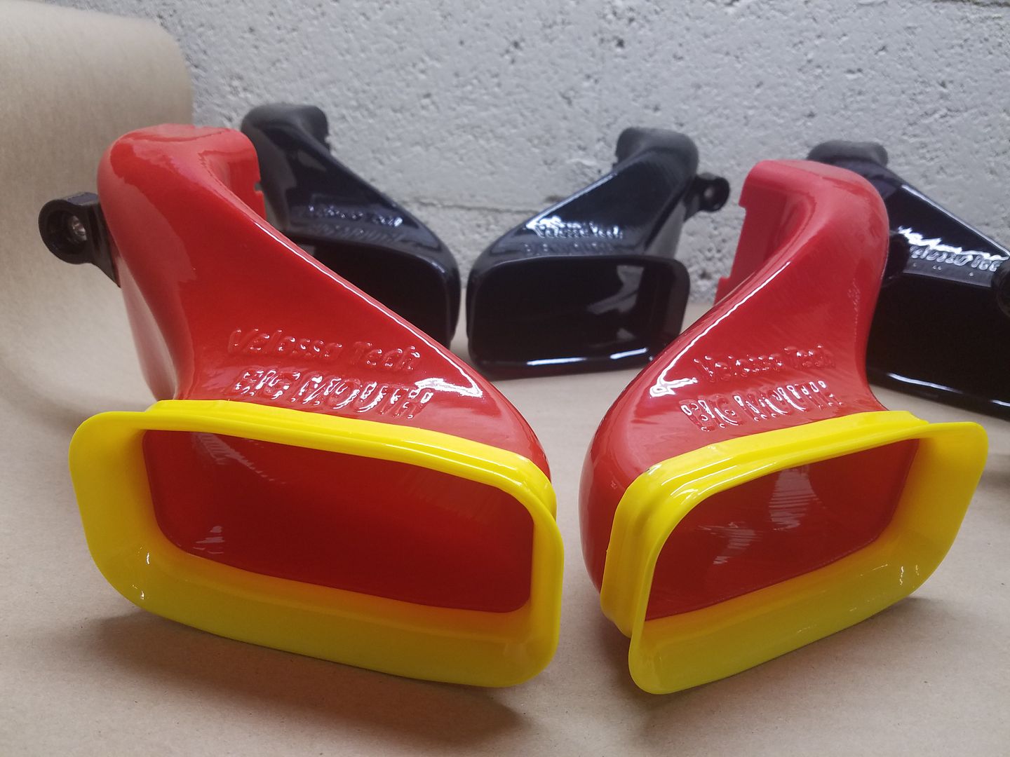

KHARTUNERZ - Velossa Tech Designs Intake Snorkel
Dunno why, I'd throw that red/yellow combo on my Ceramic! ....Pop
I have one coming for my 2.0 I should be installing sometime next week. I’ll post some photos of install and how it looks when complete.

More photos
