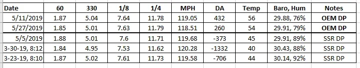

I have two more 1/4 mile dragys with my SSRs off and OEM MP back on. One was invalid slope at a different location so I won't count that (11.75). The others are all the exact same spot just different days. Top 2 are OEM MP, bottom 3 are SSR MP. You can evaluate the DAs and Temps and draw your own conclusions.
I'll have more slips this week but again the temps will be warmer.
I've never gone to a track, what does DA mean?
Density Altitude. Accounts for altitude, temp, barometric pressure, humidity, all which impact speed. My altitude is the same so biggest impact is temperature and barometrtic pressure. High temps slow, low pressure slow.
The lower the DA the faster.
