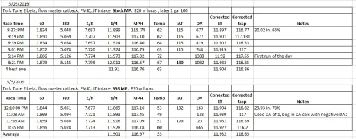

When I added the MPs a few months back I had no reason to believe there would be no gains. But I do regularly measure mods improvements doing before and after Dragy (0-60 and 1/4 mile) and 1/4 mile time slips. I'm AWD so traction is not an issue. My 0-60s where on the same day and same road, just an hour apart. I was also logging so IATs where not identical, but close. Just 2 runs before and after that install day. I've also done my 1/4 mile dragy in the exact same location and today am doing 1/4 mile at the track again. (I have about 10 slips with SSR on) If the gains can only be measured on a dyno what is the point? I want my car to be faster, sound better or look better. I'll know more tonight on if it is faster. Sound depends on if you have stock or after market catback. I have after market catback so am liking it better with stock MPs back on. I'm just trying to be helpful and share my info. I find it comical on the resistance of the best facts around on MPs. I don't feel strongly enough to go spend a couple hundred bucks on dynos.
Temps are looking to be a bit warmer today than my SSR MP visits but I think they will be close enough to see the differences. I would think the MPs would do a little bit but they certainly seem like the smallest HP mod you can make.

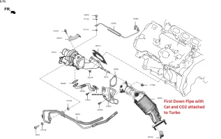

I call this the secondary down pipe which has the secondary cats it attaches to the primary downpipe and the mid pipe.Primary.webp Secondary.webp

I call this the secondary down pipe which has the secondary cats it attaches to the primary downpipe and the mid pipe.View attachment 25144 View attachment 25146
28530 is the DP
28600 is the MP.
28650 is the beginning to the catback
28711 is the axle back, also part of the catback
Just because you're calling it a secondary DP doesn't mean you're right lol.
28600 is the MP.
Right or not my description makes more sense to me than yours. What I call the secondary downpipe that you call the mid pipe comes "down" from the primary downpipe off the turbo. After that is the mid pipe basically the middle of the car.
But whatever everyone has their own opinion just would be good if everyone referred to things by the same name.
That's literally my point.
The dp comes directly off of the turbo. The mp is in the middle of the dp and catback. The catback is back off the cats....hence catback. The axle back is back from the axle.
Please read post #1 made by the retailer. They are calling these secondary DPs. It has been detailed there to prevent confusion.
You are adding to to the confusion right now because you obviously think you are right and the others are wrong. Different platforms, tuners, or manufacturers may have different terminology.
He is right, but so is the manufacturer. The "primary downpipe" is also commonly referred to as the "o2 housing" on numerous vehicles. Its length on the stinger is likely why its named differently. The secondary downpipes should in theory be called mid pipes, or part of the "long dowpipe" as some platforms have the option to buy it and the primary's together in one piece.
Hit the track last night. Still seems the Mids don't do anything Sorry. :(
