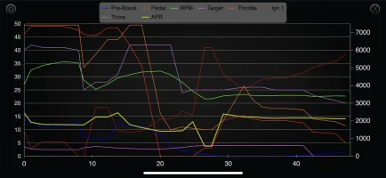

I am running map2 with v5 and I think I have run into the overboost issue two or three times with 0 boost on the stinger stock gauges requiring me to pull over, turn the car off and turn it back on again to get boost. I have the SSR downpipes, JT FMIC and intakes but haven't been able to log it the times it has happened. Would this be something just to tune out with the JB4 or is this more of a BPV problem? Guessing logs will be required?

Sounds like the overboost / turbine overspeed that others have reported.
Terry has told others that he needs a log from the pull that causes the code, logging after you have 0 boost does him no good.
If you could get that and post it, it would certainly help out the community.
Did it come up when letting off the gas or during partial but not full throttle? If so something else to test would be setting FutureUseD Bit#1 on (FUD will show as 2 after saving), which disables the pedal input boost target smoothing, that I suspect caused that issue in another car.
If that doesn't fix it then just email me a log so we can keep working on it for you. terry@burgertuning.com

I'll give it a try and see if I can replicate the issue first before I try those options above so we can put a pin in the problem. I only noticed that I had no boost while on partial throttle when coasting on the highway and then went to give it some but I don't know when exactly the loss of boost first started as I would have accelerated out of a turnoff before - thus it could have been any of the options
