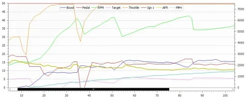

Also, quick log of the new boost by gear logic in action. You'll notice how boost during launch mode is actually around 2psi less than stock to avoid wheel spin and then it ramps up as we go. Run was a 12.4@115 on map3. :)
