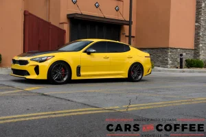

My H&R Springs are installed and the overall stance is much improved. What I didn't expect is how much better the car feels, more planted but more compliant at the same time. Small bumps seem to be absorbed more efficiently and their feels like there is less body roll.
Can you post some pics of your car with the H&R Springs?

19x8.5 Vertini VS Forged VS03 Brushed Double Dark Tint 5x4.5/114.3
245/40/19 Michelin Pilot Sport 4S
Rear:
19x9.5 Vertini VS Forged VS03 Brushed Double Dark Tint 5x4.5/114.3
275/35/19 Michelin Pilot Sport 4S
