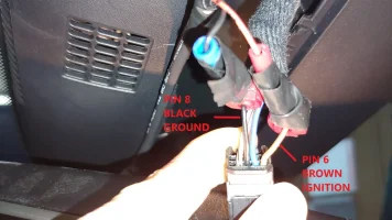

I just had to tap into ignition (pin 6) and ground (pin 8) wires to power the auto dimming. Not too difficult.

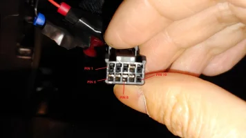

I took some photos of the wires and T-taps I used for the aftermarket mirror.
Tap Pin 8 (black color wire) for ground. Tap Pin 6 (brown color wire) for ignition.
On Stingers that did not come with factory Homelink, Pin 10 (battery) is blank or not connected. If you bought an OEM Homelink mirror from a Premium, GT1, or GT2 model, you have to wire Pin 10 for the Homelink to work.
Lastly, another poster mentioned that Stingers with autodimming side mirrors use the sensors in the main mirror for the auto-dimming side mirrors.
That is probably true. But since 2018 base and GT models did not come with autodimming side mirrors, wiring an aftermarket mirror should not cause a problem.

Here's the ten-pin plug, with six wires being used for the stock mirror
Here's the mirror that I'm replacing the stock mirror with
Here's the harness for the new mirror, it is still the same ten-pin plug, but with five wires used.
Now the stock harness is PNP.
BUT if you were curious for the pinout of the five wires, here are some snapshots of those wires.
