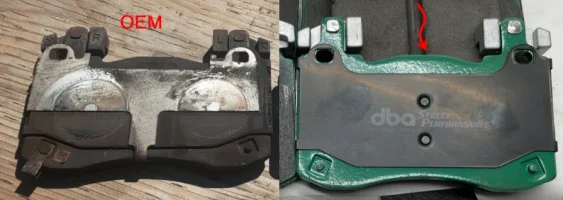

The top of the Kia pad has a bit of a different contour as well where the anti-rattle hardware pushes down. We've had 1 issue with that.
-Ken
Please forgive my re-use of your image - but for clarity, are you saying there was 1 issue where someone had a fitment issue related to around here (red arrow)?
do you know what the resolution was? (I have seen people put the anti-rattle hardware on upside down)
