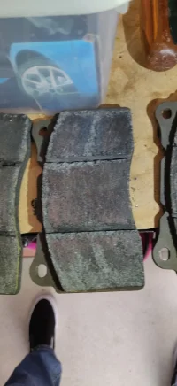

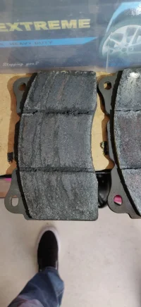

My EBC yellow stuff pads got way too hot and basically fell apart (attached). Project MU were way better but still not great. So I either brake earlier/run slower lap times :( or find a better brake solution without spending a fortune hopefully and no more trial and error. Would love to hear someone has already found a solution.
Yikes you shredded those, I've heard of other people having the same results from the yellow stuff pads after a track day. Apparently the blue stuff pads are supposed to hold up much better on the track.
Hmmm...might look into the Blue Stuff. Thanks.

so, do you think part of the problem with the yellow stuff was going in you already had some deposits on your rotors, so the aggressive braking just made it much worse than if your rotors where clean and smooth? One thing I did note is the description on the Yellow stuff pads (khartunerz website) says it's a good track pad for cars up to 3500 lbs, or something along those lines.
No. Definitely no deposits at the start of the day. Freshly skimmed rotors and brand new pads. I did have to run off through the sand trap once so I looking back I guess some stuff could have got in there... :( Def thinking the yellow stuff isn't quite high spec enough.
