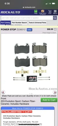

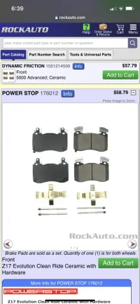

These are the pads I got. Rotors get here Friday so I can let y’all know what I think by Saturday. Ive attached a photo of the pads.You can get them direct from Brembo for $100 a wheel.

Actually those are the wrong ones. I got these.These are the pads I got. Rotors get here Friday so I can let y’all know what I think by Saturday. Ive attached a photo of the pads.
