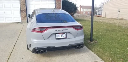

Top and bottom of all four of the existing holes have to be trimmed. There is still a slight pressure fit with the new tips.
No problems with exhaust burns from being so tight? I bought the same ones and my exhaust shop wanted to cut out the whole bottom part. Have not done that?

The exhaust tips on the stinger are not physically connected to the exhaust (v6 at least, assuming same on 2.0). You won’t get heat damage via transfer.
I have these same tips and the only modification I made was a tiny bit of grinding with a dremel to the bottom of the inside holes. Outside holes popped right in and there have been no heat issues. One issue I have been experiencing is the far left tip rotates a bit over time no matter how much I tighten it down. I'm going to get a heat resistant wrap for that one to make the fit more snug.
That's true for the OEM tips, but on these aftermarket tips you connect them directly to the exhaust pipping.

does it not get hot enough to damage plastic bumper?
Yea, clamps directly to the tips coming out of the muffler. I've not had any melting/warping issues in about a year.
