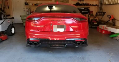

Rango, hope you don't mind, stole some of your idea's. Mostly, under hood. Where are you from?More pics.

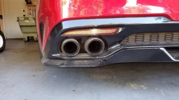

Close up with flash.
What you would see ... no flash.

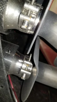

Clamps on stock, 2.5 inch muffler.

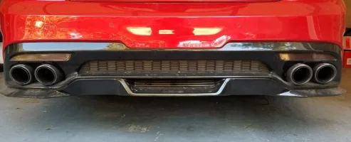

Two more pics
for the road!

Hey Rango, in a previous post I think you said you got the 2" in and 3.5" out, but on this post you mentioned 2.5". Just wanted to make sure which size is correct, thanks!More pics.

Thanks for clarifying! Look at you, always so helpful hahahaMy bad. Correction. The Akrapovic tips are 2 inches (51mm) in and 3.5 inches (89mm) out. These will fit the stock muffler pipe.
This size was used for stock exhaust pipe correct? I wonder if same size would work on Borla exhaust.Aliexpress. 2" inlet to 3.5" out. Some careful cutting of the existing holes is required to make them fit.
Yes, this inlet size is for the stock exhaust pipe. Don't think this will fit Borla. I believe Borla has a 2.5' pipe. However you could specify the 63mm (2.5') inlet on the Aliexpress site for this tip. They come in many different sizes.This size was used for stock exhaust pipe correct? I wonder if same size would work on Borla exhaust.

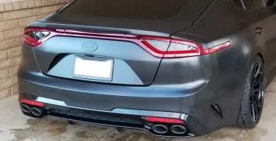

I admittedly didnt read this thread but I will say I powder coated my stock tips matte black for under $100 using a powder coat kit / powder from Harbor Freight, a coat hanger, and my home oven. They turned out great. I can now powder coat other things as well and powder is cheap.
looks awesome...skip the $1200 borla tips and go this route! Well doneAttached a picture of what the stock tips look powdercoated.
