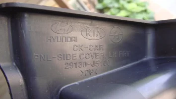

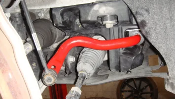

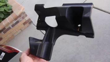

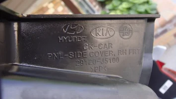

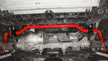

Okay. Almost done. What's with the shrouds/boxes? Nobody ever mentioned these before. The installer said that they were "in the way" and wont' be needed with the Eibach.
The added front sway bar is a noticeable upgrade in steering feel as I corner "spiritedly". I tried it out on three corners that I am intimately familiar with and found the communication through the steering wheel to be far less unsettled or twitchy: which is the onset of oversteer; that is gone. And the front end feels more solidly planted, so, I guess less body roll that I had been accustomed to from the beginning. :thumbup: :) :cool:
But, what are these "covers"? The installer removed them and said something about "in the way". I can't even picture where they go.

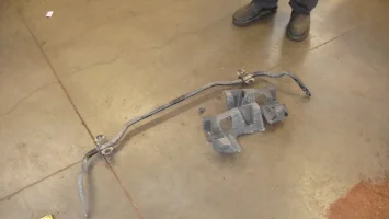

Ah, AWD, I hadn't thought of that difference. But why would they be "in the way"? You can see that they went with the OE front bar; it the first pic 3.3TT - Eibach sway bar both or just rear for AWD Stinger they are related to that removal somehow.

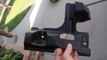

Thanks. But do you still have them? What do they cover?

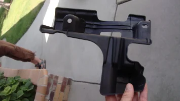

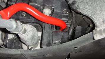

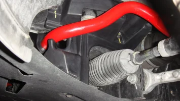

I think they go above/behind the sway bar brackets. Copied from someone else’s post, I didn’t want to go jack up my car for a photo shoot.
Thanks.
That is clearly the object. But, what is it's purpose? I can't see that it "covers" anything.

most likely to keep the underbody tray in place, by keeping it from moving. also could be for wind deflection or to prevent road debris from going somewhere it shouldn't.
can you live without them? I'd say yes. Were it my car, I'd be under there putting them back on, or driving back to the shop to have them do it. no one else with aftermarket sway bars has needed to remove those.
If you live in a shit climate with road salt/snow I'd keep them on, probably not necessary in a warmer climate. I had to take those off when I removed my front axles to get more leverage to pry them out.
I just got back from having the "covers" put back in. And after a closer inspection, with the undercarriage panel back in place, I can see what the function of these is: to deflect any debris coming up through the "aerodynamic slots" from impacting the steering arm boots behind.
