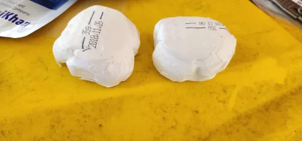

So, just 7 months later I checked both sides, and both desiccant packs are hard as rock. The right side had expanded enough to twist the bracket out of shape so I replaced that with a spare I ordered back in May. That one had the bracket installed with the prongs facing inward (toward the wheel well). The bracket with the prongs facing outward did not have to be replaced.

I just had mine replaced and there was scuffing on both desiccant retainers, and the OEM packs were as hard as a rock and taller than a hockey puck.

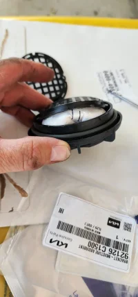

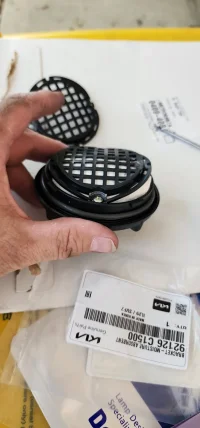

I wasn't able to find the Hyundai parts listed in the TSB above, so I ordered the OEM brackets and new desiccant. After removing the old brackets it was very apparent that the stock foam/desiccant had expanded and ruined the brackets, which prevented the dynamic lights from functioning correctly (see picture). After replacing the brackets and desiccant everything is working correctly again with no failure lights.
THANK You for sharing. I'm sure you saved me quite a lot of $. I took the same picture, but my knuckles got a little more scraped during the operation on account of my clumsiness.

It may be as simple as replacing the desiccant pack in each headlamp. As they age they absorb moisture and swell. However in the OEM lamps the desiccant pack is too large; it swells and gets hung up on the inside of the access cap. There is a service bulletin for this, you will need to replace the pack and they redesigned the access cap. If you have access to remove the wheel you can do this yourself.

Exactly. Once they swell and get hard as a rock, they don't do their jobs. The best thing I can suggest is to watch the cold areas of your headlamp for fogging. This would be the upper corner by the fender/hood cut line and low on the lamp near the fascia. Once they headlamps aren't clearing like they did, time to replace them again. It will also probably happen sooner because the replacements have less volume.
