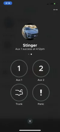

I have drone mobile installed with a compustar brain on my 2018 GT2 and I am able to start my vehicle and turn on the heated seats / steering wheel with the AUX 1 function.
Really?! Is there anything special to do to set up that Aux 1 setting? I just pushed it to see if anything happened.

It has to be wired in which from what I was told by the installer it wasn't super complicated just some extra wiring and panel removal. I had it professionally installed by a local shop.

Just had this done today. Aux 1 turns on heated steering wheel & both heated seats. Aux 2 turns on both cooled seats. Works perfectly!
