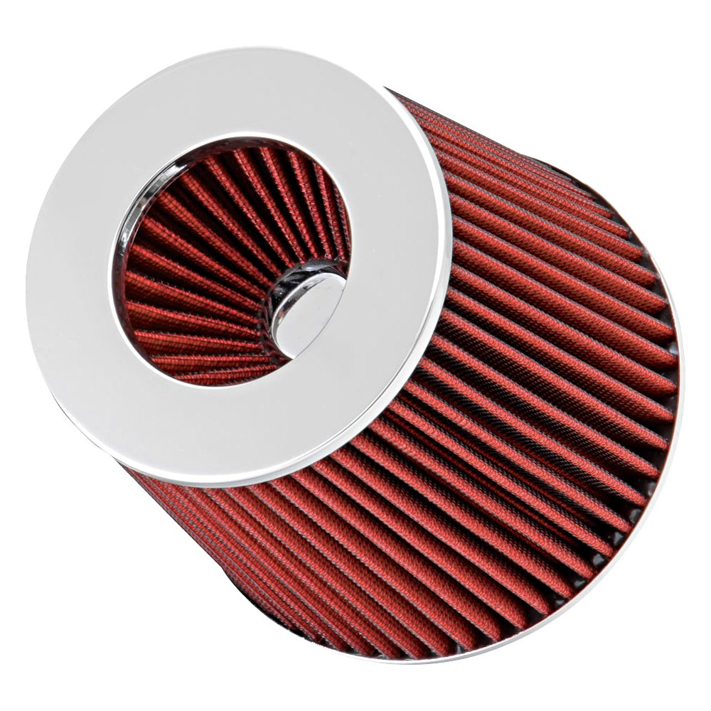

I see some filters with a "closed top", others with what appears to be an opening in the top. Those that are open - do they have more filter material to filter air coming in that way? Some of the pictures make it seem like it's a fully unfiltered 1-2" hole passing right through the middle, which seems like it would be bad? Or is that just an illusion?

Yes the open top version has considerably more filter area and in turn more airflow.:thumbup: And no they don’t have an unfiltered hole, its completely covered in filter material just more of it.

So the lighter-colored inside part is an internal cap, right? It's been a long time since I looked at filters - stock airbox wasn't a limitation on the Legacy GT until > 350 chp, so I just stayed stock for 15 years..

Yes there is a small cap inside the inverted part of the filter so it’s completely sealed.

I originally ordered the filters with the extra filter material on the inverted center portion, but I returned them when I saw a few (like 3) negative reviews, one of which included pics of a damaged turbo because the chrome cap got sucked into the intake tract and hit the intake side of the turbo. Even if the frequency was very low and likely a manufacturing defect, I didn't want to take the risk and exchanged for closed top AEM Dryflow filters. They have a little less filter material not having the inverted portion, but I feel safer with the closed rubber top on the filter instead of a glued in chrome cap.

The K&N RG-1001RD universal filters were the ones I bought and returned. Both Amazon Canada and USA had a 1 star review with damages turbos and pics as well because the cap was sucked into the intake tract. Not sure if I saw this on the Spectre but since they are designed the same way it is possible. Seems like a low instance rate and we might not be pulling enough air for this to happen but not a risk I was willing to take.

I didn't mean to strike fear into anyone running the inverted cap style filter. It is true that the ones that have failed are likely manufacturing defects (not enough adhesive used) or more likely poor filter selection / installation error. I personally went with the "safer" looking filter just because I'd be constantly obsessing over the possibility of failure, no matter how likely, so I went the safe route to keep myself sane. Considering how small our turbos are and the fact I think the highest boost I've seen on this forum is 22psi, I don't think we are pulling in enough air to rip a cap off a filter, unless there was a manufacturing defect on the filter itself. The filter I chose which has a similar external surface area as a Spectre for the OD I believe calculated to about double the surface area of the factory panel filters, so we probably have more than enough CFM on the filters we are using to support a lot of extra boost.
