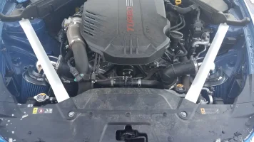

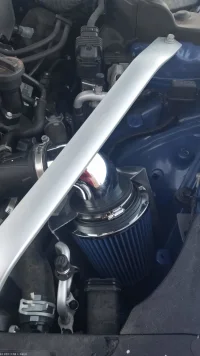

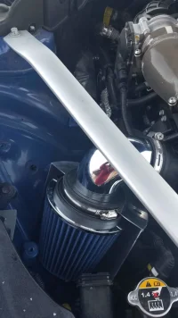

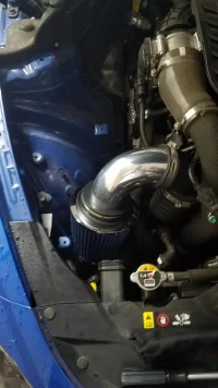

I added heat shields to my Spectre filters today. These are Spectre 8130 heat shields to go with the 8130 series filters. $20 CAD each on Amazon. They slip under the hose clamp that holds the filter to the pipe and fit really well.
The passenger side shield fits with lots of space but the drivers side is a lot tighter. I had to trim the corner of the shield on the fender side with some metal shears in order to get it to sit where I wanted it so that it won't rub on anything.
Overall though these fit great and should help with heat soak. They should also help pull in more cold air especially with the Big Mouth snorkels.

can you provide part number for heat shield an where you purchased?
With these heat shields on you won’t need a bracket anymore. I did use a bit of foam tape to make a snug fit and eliminate any movement.
How have your DIY Intakes been holding up? Everything still fine? Did you ever make a bracket for these?
never made a bracket after driving for didnt feel it was necessary.....there solid and the car has been running good.......i added the snorkles and seen a huge difference in lower temperatures on the air on the JB4....i am wondering if these shields would help... i assuming they will when the car is still and not moving....

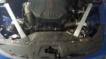

Finished my install. Again, I appreciate all of the input. I think I may have ordered the wrong 90 degree pipes, though. Tight fit, and there was no way to get the heat shields in. Sounds pretty good, but I thought it would be a little louder.

Nice. I didn’t use the 90degree pipes so not sure the difference but they look a little long. That also could be making it quieter as mine seems pretty loud.
The smaller elbow or short straight tubing like I used may be louder and make the shielding fit better.
