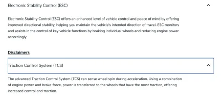

Basically the way they present TC on the '22 GT Line is what brake based torque vectoring does:
Traction Control System (TCS)
The advanced Traction Control System (TCS) can sense wheel spin during acceleration. Using a combination of engine power and brake-force, power is transferred to the wheels that have the most traction, offering increased control and traction.
That would seem like it.
Stability control usually does the opposite, cuts power and brakes based on yaw angles to keep the car in a straight line. Traction control is similar, but interested only in putting power to the ground and therefore cuts power when it detects slip. Active torque vectoring is more to make the car go in the direction intended and not just cutting power.
Ok, I checked and I think I've got it.
On the US '22 GT Line website you have the following 2 options: Electronic Stability Control (ESC) and Traction Control System (TCS). First one cuts power, second adjusts traction.
On my car, I have two called VSM (vehicle stability management) & ECS and a third called DTVC (dynamic torque vectoring control) which is probably same as TCS.
