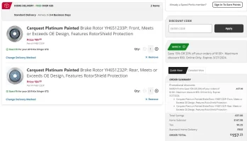

Mine is a 2.0T it’s a 2020 GT-Line. So I should just be able to get the carquest platinum for the 3.3L and they’ll fit fine? They are still reasonably cheap on advanced auto parts, about 260 shipped with a discount code! That being said that was for the 2.0T rotors so I don’t know how much the 3.3L will be. The EBC rotors are about 600 for a full set now.

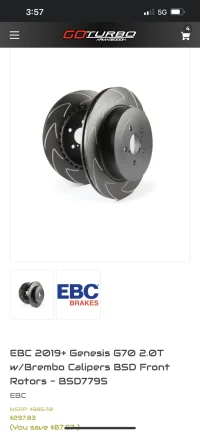

Would these work for the 2.0T with brembos? I was planning on getting the green stuff brake pads with it. Sorry for all the questions, just want to make sure I’m getting the right things!

Still not too bad.
Shipping is free, but the discount code caps at $50, so you can get them in two separate orders. Should be a little over $300 shipped.
That said, if you just get the equivalent EBC rotors (no fancy drilled/slotted), they are RK7795 and RK7794. Search around and you should be able to get them for about the same $300 for all 4 rotors.
Should. The surface V-slotting I couldn't care less about. However, the directional internal "bladed" channels are supposedly better able to vent air flow through the rotors - same way the vanes in a centrifugal pump moves fluid outward radially. That does hold some merit and might be worth paying extra for. How much better that works vs. regular straight radial vents channels? Dunno.
